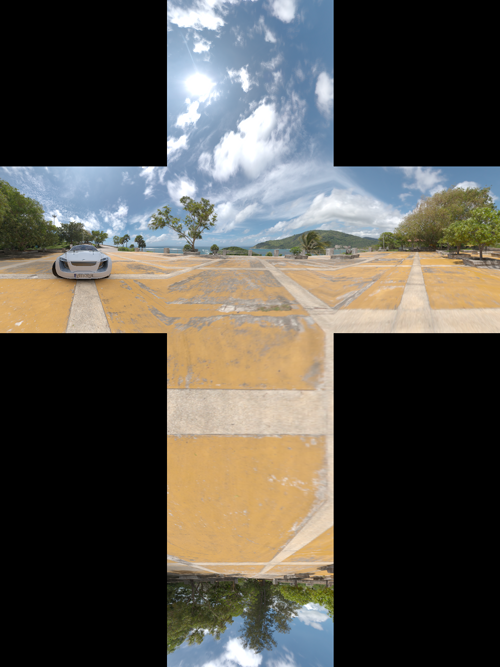

Vertical Cross rendering

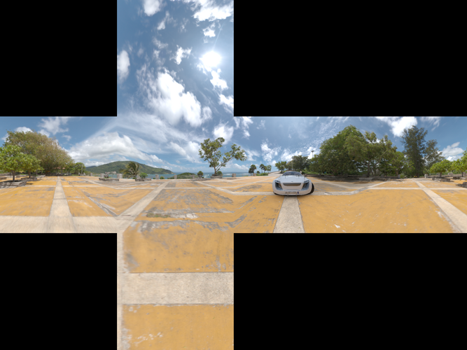

Horizontal Cross rendering

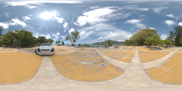

Spherical Map rendering
