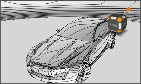

In Isophotes mode, a virtual light source provides defuse illumination to the object geometry. All points sharing the same brightness value are connected with a line.

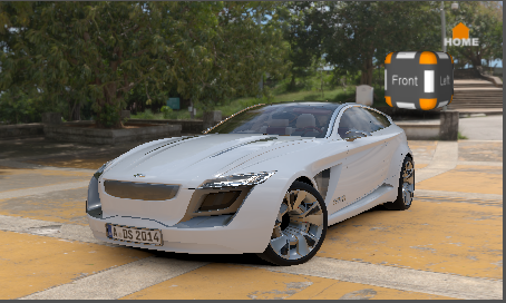

Surface Analysis Off Surface Analysis On - Isophotes Mode
Analysis Off Analysis On
  1. From the Analysis Mode box of the Surface Analysis dialog box, select Isophotes.

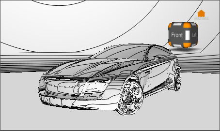

In Reflection Lines mode, lines on a virtual plane are reflected onto the surface of the geometry.
Surface Analysis On - Isophotes Mode Surface Analysis On - Reflection Lines Mode (Parallel Linear Lines)
Analysis On Analysis Off
  1. From the Analysis Mode box of the Surface Analysis dialog box, select Reflection Lines.
  2. Select Parallel Linear Lines on a Plane.

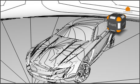

  4. Alternatively, select Longitudinal Lines on a Sphere under Analysis mode.
    This creates a sphere with lines reflected on the geometry.
