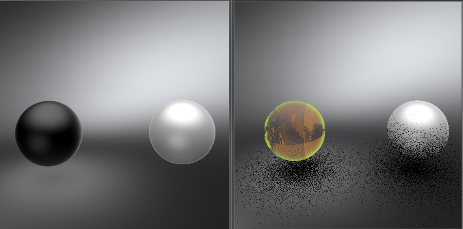

IMPORTANT If an X-Ray material is in a layered material, the effect is not visible in OpenGL mode. It is visible, however, in Raytracing mode. In the images below, the first is an example in OpenGL mode. The second is in Raytracing mode.
