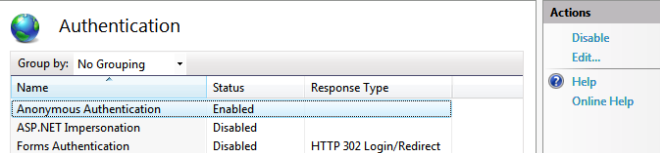

  1. Go to Administrative Tools and open Internet Information Services (IIS).
  2. In the Internet Information Services dialog box, expand local computer ► Sites, and click Default Website.
  3. Double-click Authentication.
  4. Click Anonymous Authentication and make sure it is enabled.
  5. Right-click on Authentication and select Edit to display the user name of the anonymous account used by IIS. Verify that this account exists on the server.

  4. Double-click Internet Information Services.
  5. In the Internet Information Services dialog box, expand local computer ► Sites, and click Default Website.
  6. Double-click Authentication.
  7. Click Anonymous Authentication and make sure it is enabled.
  8. Click Edit to display the user name of the anonymous account used by IIS. Verify that this account exists on the server.
