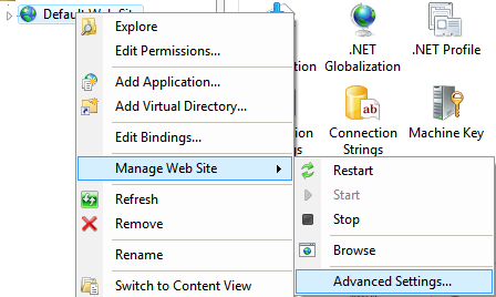

  3. In the Internet Information Services dialog box, expand local computer ► Sites and click on Default Website.
  4. In the Manage Website section, click Advanced Settings.

  4. In the Internet Information Services dialog box, expand local computer ► Sites and right click Default Website and select Edit Bindings > Manage Web Site > Advance Settings.
  5. Expand Connection Limits, change the Time-out value to 900, and click OK.
