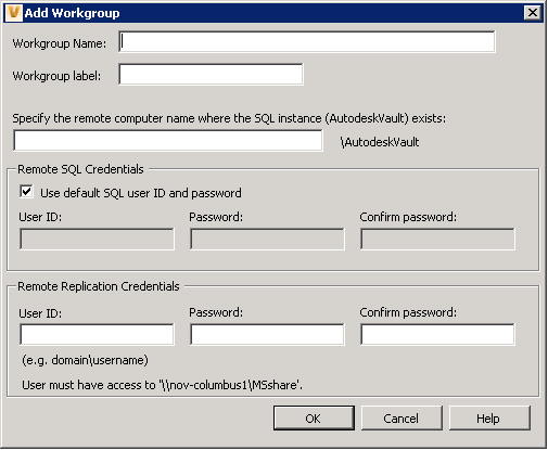

Vault does not support connected workgroups on Microsoft SQL express. The full version of Microsoft SQL must be installed with a database instance named "AutodeskVault" before installing the Vault server.) For more information, see Pre-Install Microsoft SQL.
If you created a replication user account, use those credentials under Remote Replication Credentials.
Configure Firewalls
Before adding a workgroup be sure that the SQL server can communicate with the Vault server through the firewall. This can be done by allowing an exception for the SQL executables sqlbrowser.exe and sqlserver.exe.

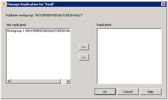

Once you have configured the publisher, you can install the Vault server console on the subscriber and enable Vault replication.
Vault opens information dialog boxes that describe the vault synchronization frequency and tell you that the vault has been enabled.
