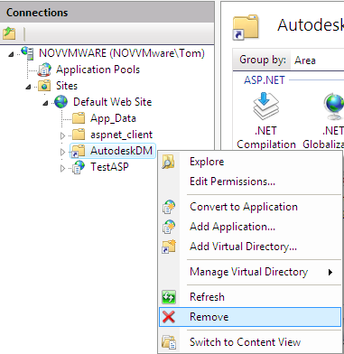

  3. In the Internet Information Services dialog box, expand local computer ► Sites, and click Default Website.
  4. If you see a folder named AutodeskDM, right click this folder and select Remove.

  4. In the Internet Information Services dialog box, expand local computer ► Sites, and click Default Website.
  5. If you see a folder named AutodeskDM, right click this folder and select Remove.
