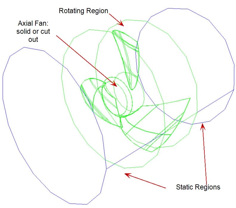

- The typical model configuration for axial fan models consists of the impeller surrounded by a cylidrically-shaped rotating region. Extensions are added to the inlet and outlet, and extend 3-4 hydraulic diameters from the rotating region:
