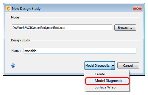

You can also activate the MAT when you import geometry directly into CFD without the use of a CAD application. Select the option for Model Diagnostic from the button menu, as shown in the following image. When this option is selected, your model opens into the MAT.
