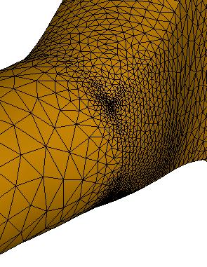

When the Edge Merge tab is active, edges that can be merged are marked with an arrow. The mesh that is created on the geometry without merged edges is also shown.

Image of mesh after edges are merged:
