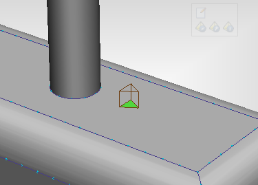

To Preview the effect of Automatic Sizing Refinement
This is enabled after Surface refinement is enabled from the Mesh Sizes quick edit dialog.
- Press and hold the keyboard Shift key.
- Hover the mouse over surfaces and near gaps.
A small prism indicates the element size:

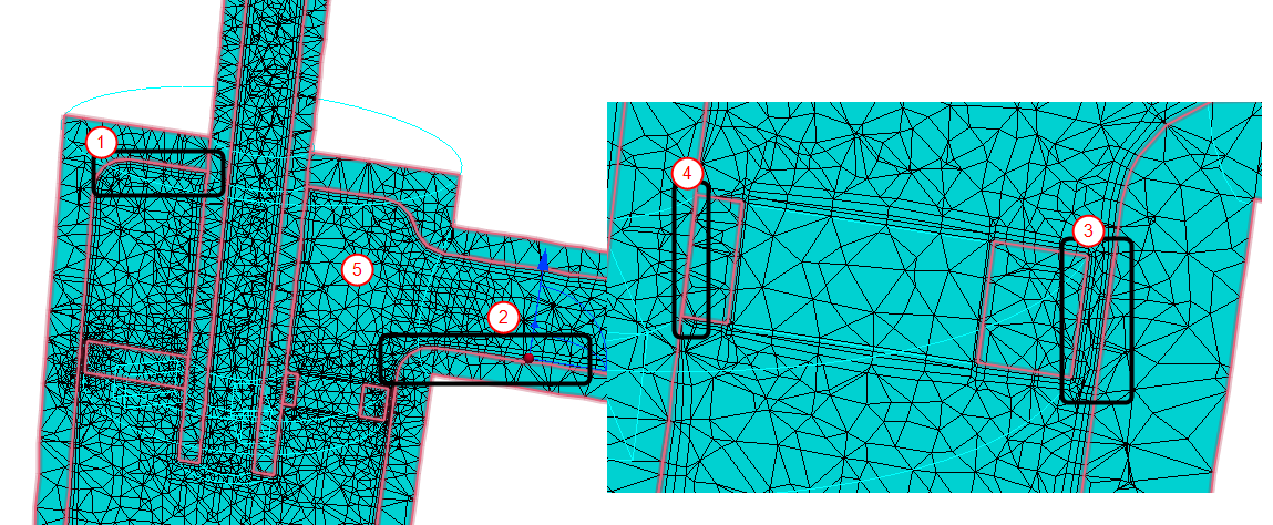

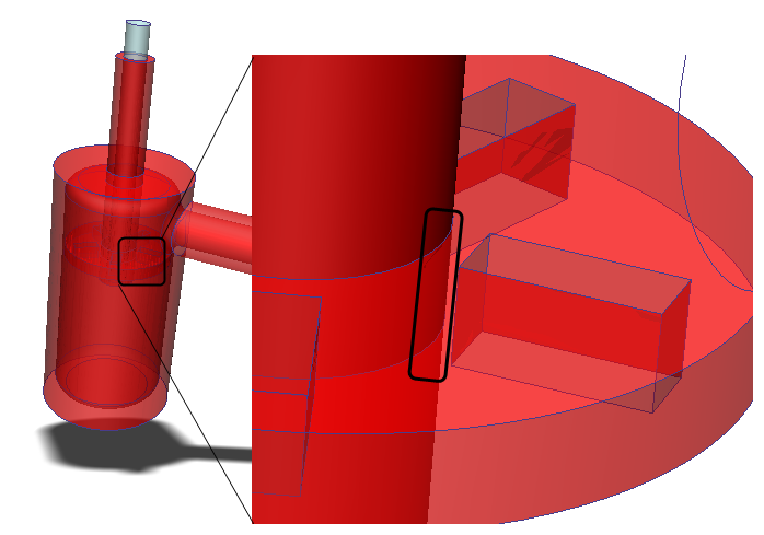

Case Study
The following model of a hydraulic valve has an extremely tiny clearance that prevents a mesh from generating successfully using the default settings:
After some trial and error, it was discovered that the mesh generates successfully if Mesh Enhancement is turned off. This is obviously not ideal because no flow will be computed through the small gaps:

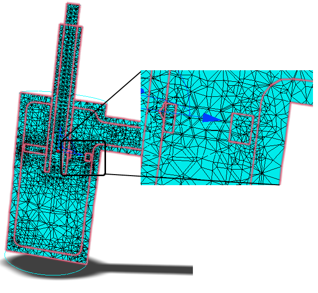

The Volume growth rate was modified, and Surface Refinement and Gap Refinement were invoked with the default settings. Mesh Enhancement is also enabled.
There were several important results:
- The mesh successfully generates with Mesh Enhancement layers. (This is due to Surface-based Refinement.)
- The mesh enhancement layer thickness adjusts to the size of the device. It is very fine in the gaps, and thicker in the larger parts of the model. (This is due to Surface-based Refinement.)
- The mesh is refined in the important gap between the baffle and the wall. (This is due to Gap Refinement.)
- This clearance contains a mesh, but it is not refined. This is acceptable because it is irrelevant, and very little flow will pass through it. (This is due to Gap Refinement.)
- The mesh in the swirl areas is more concentrated than the default mesher. (This is due to controlling the Volume growth rate.)
