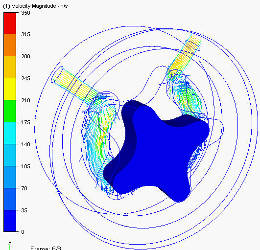

The lobed cam rotates about its center. Its lobes mesh with the static lobes of the surrounding piece. Flow is induced through a positive displacement mechanism by changing the volume of the flow region. Use Angular Motion to define this motion. |
