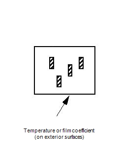

Because the device is sealed, the internal flow volume should be created automatically when opened into Autodesk® CFD. If not, ensure that there are no leaks or construct the flow volume in the CAD model. |
Specify a temperature or film coefficient (convection) on the exterior surface of the housing.
