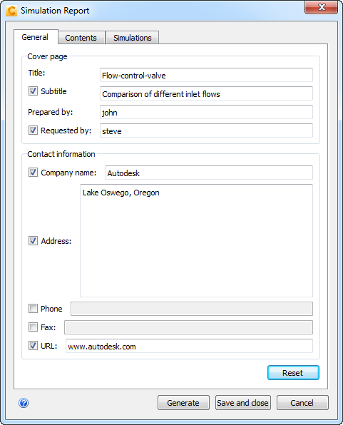

Input and modify information on the General tab to create your report cover page. Some items are populated by default, but all fields are editable. The information you enter, other than the Title and Subtitle, persists between your CFD sessions.

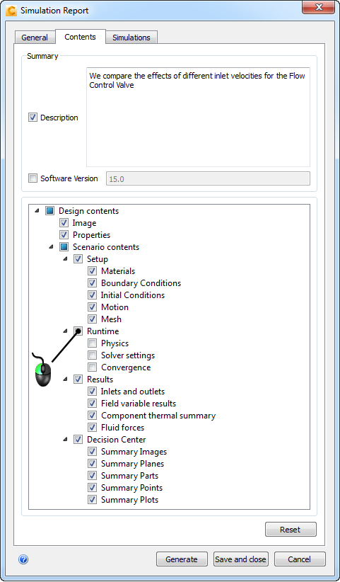

Contents

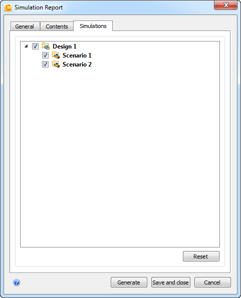

Simulations
Chose which designs and scenarios to include in your report.

Step 1:
On the General tab, activate several fields and enter information to customize the cover page.
Step 2:
On the Contents tab, add a description and exclude the Runtime contents because the requester, Steve, is only interested in the settings and results.
Step 3:
On the Simulations tab, leave both scenarios selected as Steve wants to compare the results from each simulation.

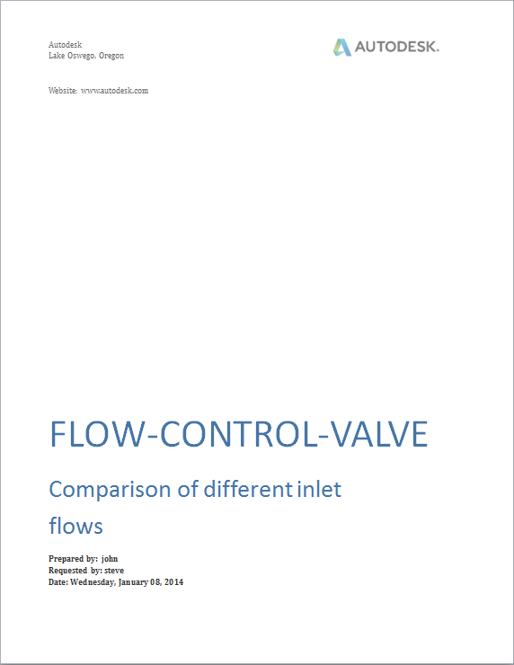

Step 4:
With the report appropriately customized, click Generate to publish the report. Here is our example cover page:
