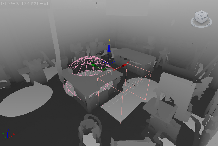

<PointCloud>.enableLimitPlanes BooleanClass default: true -- boolean
[制限ボックスを有効](Enable Limit Box)チェックボックスの状態を取得/設定します。
<PointCloud>.GlobalEnableVolumes BooleanClass default: false -- boolean; volumeGlobalEnable
[[ボリュームを表示]を使用](Use Display Volumes)チェックボックスの状態を取得/設定します。
<PointCloud>.VolumeObjects ArrayParameter default: #() -- node array; Volume_Object; SubAnim
.GlobalEnableVolumes プロパティが True に設定されたときに使用するボリュームのノード配列を取得/設定します。
<PointCloud>.GlobalInvertVolumes BooleanClass default: false -- boolean; volumeGlobalInvert
[反転](Invert)チェックボックスの状態を取得/設定します。
例: |
--Create a Point Cloud object at the world origin: pc = PointCloud() --> $PointCloud:PointCloud001 @ [0.000000,0.000000,0.000000] --Load the sample project installed by Autodesk ReCap: pc.filename = @"C:\ProgramData\Autodesk\Autodesk ReCap\Sample\AutodeskReCapSampleProject.rcp" --> "C:\ProgramData\Autodesk\Autodesk ReCap\Sample\AutodeskReCapSampleProject.rcp" --Query the scan files loaded by the project: pc.scanFiles --> #("C:\ProgramData\Autodesk\Autodesk Recap\Sample\AutodeskReCapSampleProject Support\techshop_012.rcs", "C:\ProgramData\Autodesk\Autodesk Recap\Sample\AutodeskReCapSampleProject Support\techshop_013.rcs") --Create some geometry to use as Display Volumes: s1 = Sphere radius:50 pos:[-50,0,0] --> $Sphere:Sphere001 @ [-50.000000,0.000000,0.000000] b1 = Box pos:[-50,-80,0] width:60 length:40 height:50 --> $Box:Box001 @ [-50.000000,-80.000000,0.000000] pc.VolumeObjects = #(s1,b1) --> #($Sphere:Sphere001 @ [-50.000000,0.000000,0.000000], $Box:Box001 @ [-50.000000,-80.000000,0.000000]) --Enable the display volumes, invert to cull inside the volumes: pc.GlobalEnableVolumes = true --> true pc.GlobalInvertVolumes = true --> true --Increase the quality at cost of performance and increase the pixel point size pc.performanceQuality = 6 --> 6 pc.asPixelPointSize = 4.0 --> 4.0 --Display using an Elevation ramp map pc.displayTechnique = 3 --> 3 |
