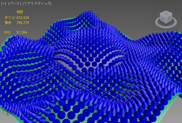

	resetMaxFile #noprompt
 --Create some geometry to test against
	local p = plane width:210 length:210 widthsegs:200 lengthsegs:200
	local s = sphere radius:50 segs:100 pos:[14,15,-25]
	local n = noiseModifier()
	addModifier p n
	n.strength = [0,0,50]
	n.scale = 50.0
	local theObjects = #() --collect objects to be placed in this array
	for y = -100 to 100 by 5 do
		for x = -100 to 100 by 5 do
			local c = cone pos:[x,y,100] radius1:3 height:5 wirecolor:blue --create a grid of cones above the surfaces
			append theObjects c --collect the cones in the array
	local st = timestamp() --get a time stamp
	for o in theObjects do --loop though all cones
		local result = PlacementTool.HitTestScene (Ray o.pos [0,0,-1]) --intersect a ray down the -Z
		local minDist = 100000.0 --initialize a variable for the minimum distance
		local newPos = o.pos --set the new position to the current position of the current cone
		local newNormal = o.dir --set the new normal to the current direction of the current cone
		local theTarget = undefined
		for i in result do --loop through all results
			local dist = (distance i[2].pos o.pos) --calculate the distance to the hit
			if dist < minDist do  --if it was closer,
				minDist = dist --set the minimum distance to the current distance value
				newPos = i[2].pos --record the position
				newNormal = i[2].dir --and the normal
				theTarget = i[1] --remember the object that was hit
		if theTarget != undefined do --only place the object if a target was found
			PlacementTool.PlaceNode currentTime o &newPos &newNormal theTarget true
	format "Placement of % objects took % ms.\n" theObjects.count (timestamp()-st) --print the time
