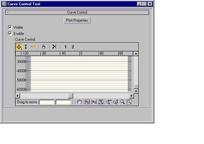

例:
rollout uTestCurveControl "Curve Control"
-- Curve control Properties
local ccProps = #(
#visible,
#numCurves,
#x_range,
#y_range,
#displayModes,
#zoomValues,
#scrollValues,
#commandMode)
-- Curve properties
local curveProps = #(
#name,
#animatable,
#color,
#disabledColor,
#width,
#disabledWidth,
#style,
#disabledStyle,
#numPoints,
#lookupTableSize)
-- Curve Point properties
local cpProps = #(
#value,
#inTangent,
#outTangent,
#bezier,
#corner,
#lock_x,
#lock_y,
#selected,
#end,
#noXConstraint)
button btn_props "Print Properties"
checkBox chk_visible "Visible" checked:true
checkBox chk_enable "Enable" checked:true
CurveControl cc_test "Curve Control:"
height:200
width:400
align:#center
numCurves:2
visible:true
x_range:[-100,100]
y_range:[-100,100]
scrollValues:[-100,100]
commandMode:#move_xy
-- The following parameters default to all flags if not specified
--uiFlags:#(#drawBG, #drawgrid, #upperToolbar, #showReset, #scrollBars, #constrainY, #xvalue)
rcmFlags:#(#delete)
asPopup:false
on chk_visible changed state do cc_test.visible = state
on chk_enable changed state do cc_test.enabled = state
on uTestCurveControl open do
zoom cc_test #all
