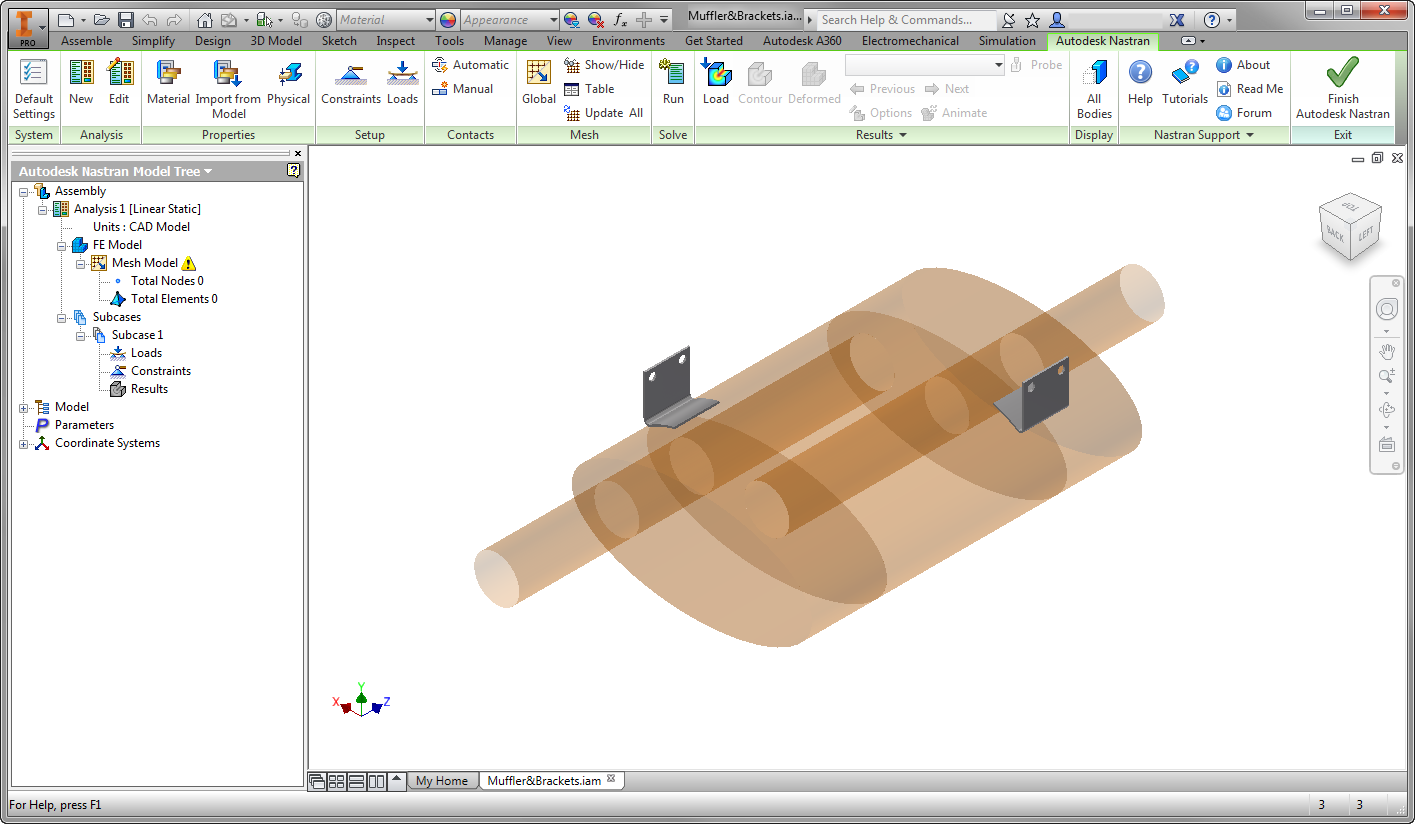

1. Open the Model and Start the
Autodesk Inventor Nastran Environment
Start Autodesk Inventor, and open
Muffler&Brackets.iam from the
Section 22 - Muffler sub-folder of your training exercises folder. (Get Started > Launch > Open)
From the ribbon, click
Environments, and
Autodesk Inventor Nastran.
You should see this:

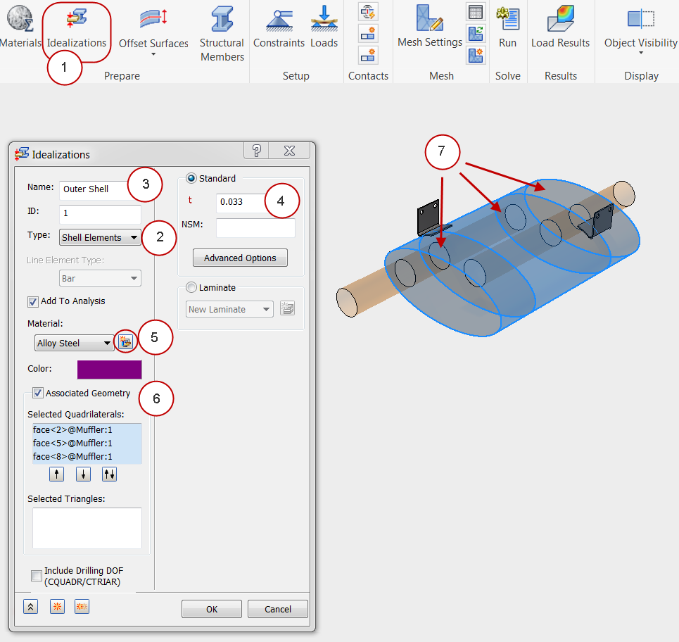

2. Define the Physical Properties
- Click
Idealizations from the ribbon.
- Set the
Type to
Shell Elements.
- Change the
Name to
Outer Shell.
- Specify a thickness, t, of
0.033.
- Click the
New Material icon. On the Material dialog, click
Select Material. Expand the
Inventor Material Library, and select
Alloy Steel. Click
OK and
OK to close both Material dialogs.
- Check the
Associated Geometry box.
- Select the three surfaces that make up the outer muffler shell.

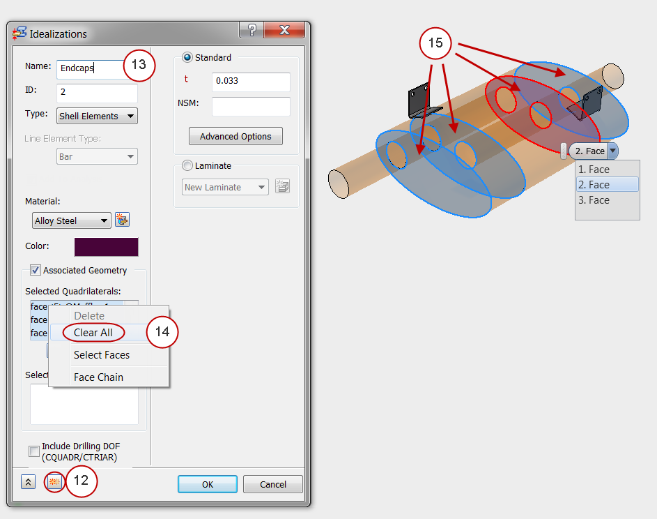

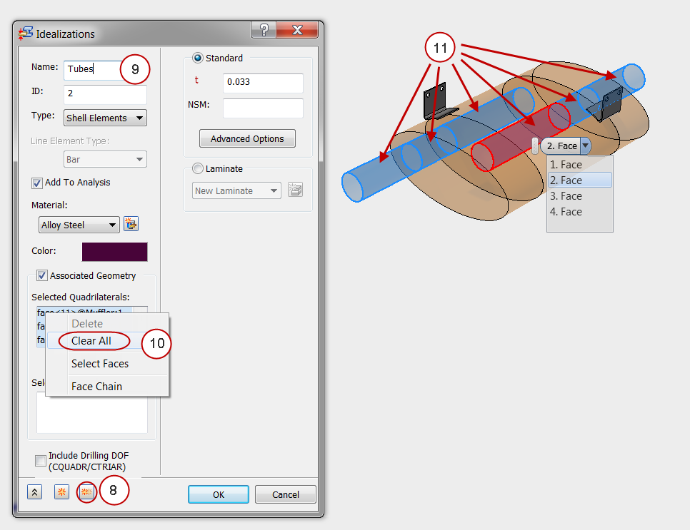

- Instead of closing the dialog, we will duplicate the settings to define the next physical property. Click the
Create Duplicate icon.
- Change the
Name to
Tubes.
- Right-click in the
Selected Quadrilaterals list, and click
Clear All.
- Select the six cylindrical surfaces that make up the tubes. (You may have to hover over the surface and expand the menu to select the correct surface from the list.)
- Click the
Create Duplicate icon again.
- Change the
Name to
Endcaps.
Clear All.
- Select the four planar surfaces that make up the end caps and bulkheads. (You may have to hover over the surface and expand the menu to select the correct surface from the list.)

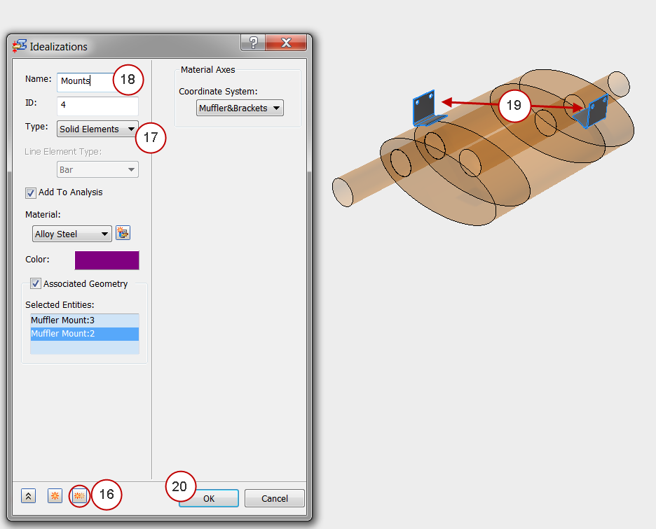

- Click the
- Set the
Type to
Solid Elements.
- Change the
Name to
Mounts.
- Select the two mounting brackets.
- Click
OK.

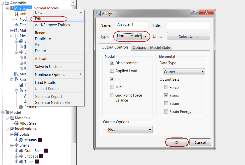

3. Change the Analysis Type
- Right-click
Analysis 1 from the Assembly tree, and click
Edit.
- Set the
Type to
Normal Modes, and click
OK.

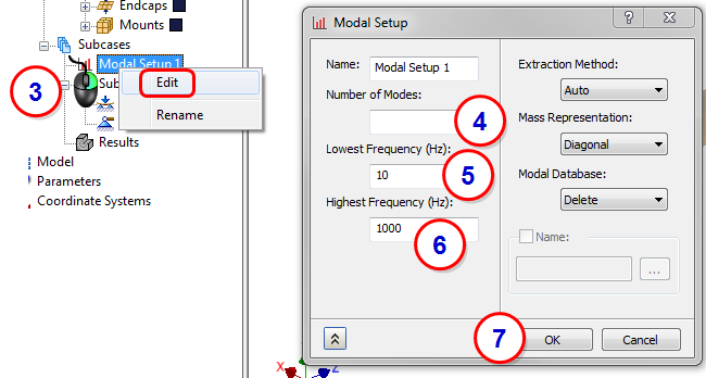

- From the Assembly tree, right-click on
Modal Setup 1, and click
Edit.
- Delete 10 as the
Number of Modes.
- Set the
Lowest Frequency to
10.
- Set the
Highest Frequency to
1000.
- Click
OK.

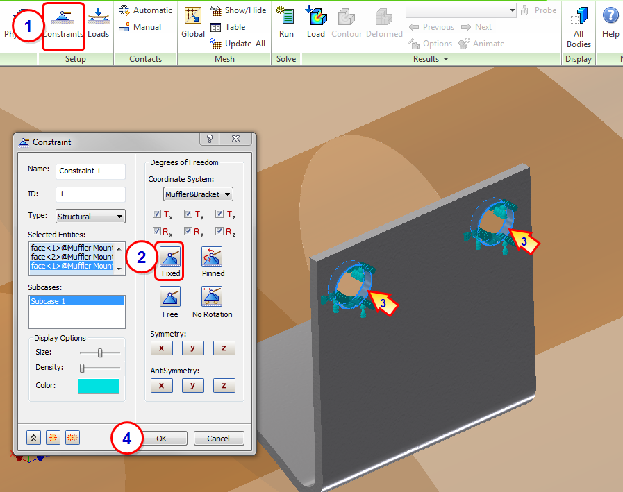

4. Constrain the Brackets
- Click
Constraints from the ribbon.
- Make sure
Fixed is selected.
- Select the two circular surfaces on each bracket. There should be four surfaces total.
- Click
OK.

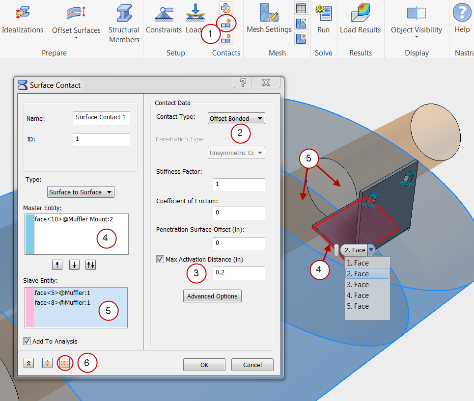

5. Define Contacts
We'll use an Offset Bond contact between the brackets and the muffler shell to ensure that parts that don't touch are bonded together.
- Click
Manual from the
Contacts panel in the ribbon.
- Set the
Contact Type to
Offset Bonded.
- Specify a
Max Activation Distance of
0.2
- Click in the
Master Entity field, and select the bottom face of the bracket. (You may have to hover over the surface and select the appropriate surface from the list.)
- Click in the Slave Entity field, and select the two adjacent faces of the muffler that contact the bracket.
- To define the contact for the second bracket, click
Create Duplicate. The first contact is added to the Analysis tree.
Master Entity field, and click
Clear All. Select the bottom face of the second bracket.
Slave Entity field, and click
Clear All. Select the two adjacent faces of the muffler.
- After the second surface contact is created, click
OK.

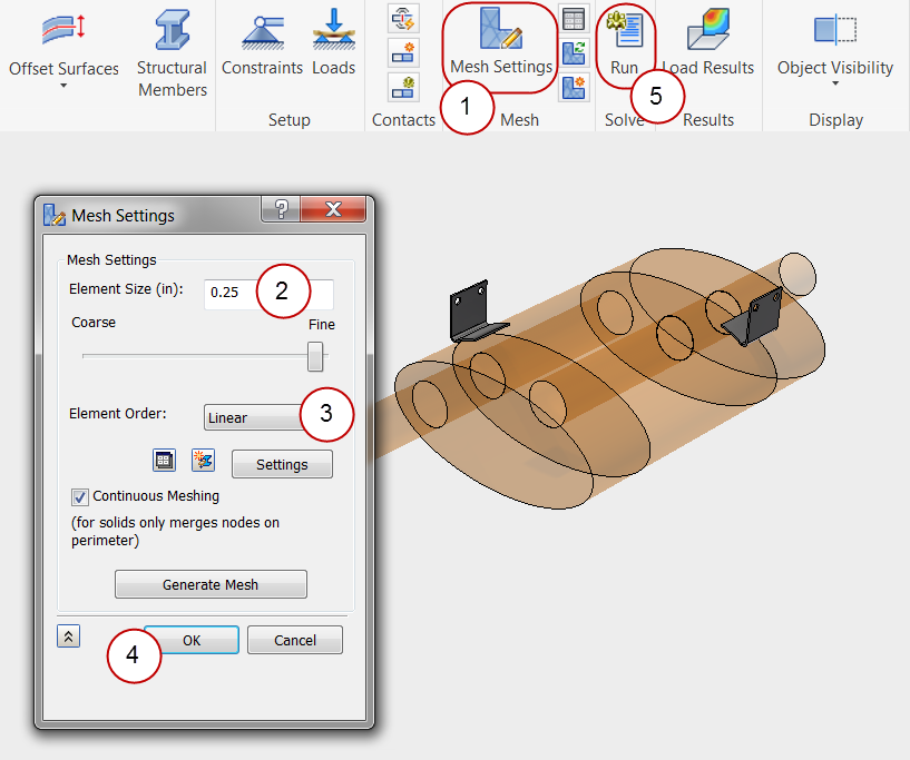

6. Mesh the Model and Run the Analysis
- Click
Mesh Settings from the ribbon.
- Set the
Element Size to
0.25.
- Set the
Element Order to
Linear.
- Click
OK to generate the mesh and close the dialog.
- Click
Run from the ribbon to start the analysis.

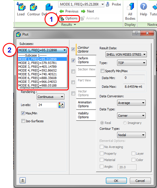

- Click
Result Options from the ribbon, or in the Analysis tree, right-click
- Open the
Subcases menu. The frequencies for each mode are listed:

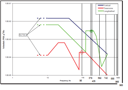

If we overlay these frequencies on the plot from MIL-STD-810G, we can identify the modes to check:
Vertical
Transverse
Longitudinal
95
no
yes
no
379
no
no
yes
405
no
no
yes

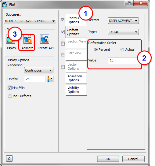

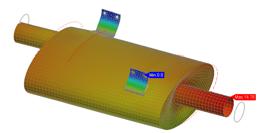

8. Review the Mode Shapes at Each Frequency
- On the
Contour Options tab, select
Displacement as the
Result.
- Click the
Deform Options tab, and set the
Deformation Scale to
10%.
- Click
Animate, and examine the model to understand the deformation.
- Repeat this for each mode shape.
- To stop the animation at any time, in the Analysis tree, right-click
Results and deselect
Animate.

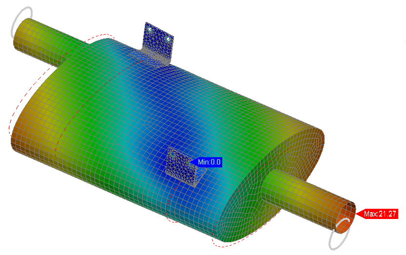

- MODE 1: High input energy in the transverse direction. The rotational mode about the brackets is mostly vertical, but could be excited multi-axially.
- MODE 2: High input energy in longitudinal direction. The oil-canning of end plates and bulkheads are clearly in jeopardy from the longitudinal vibration. To use a section view, check the
Section View tab, and choose the orientation. Drag the section plane using the handles.
- MODE 3: High input energy in longitudinal direction. This mode is a combination of transverse and longitudinal deformation. There is increased risk of failure due to high longitudinal energy.
