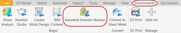

  4. 依次单击“环境” > Autodesk Inventor Nastran
