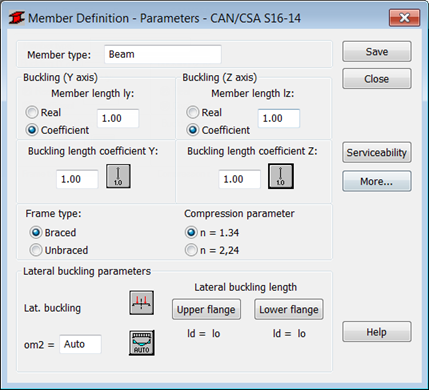

The following dialog displays:
The Member Type field displays the name of the selected member type (enter any member type name). The Buckling Y axis and Z axis fields display the length of a member for the required plane. There are two ways to define this length:
Choose the Coefficient option to define several members of different actual lengths, e.g. additional supports equally spaced. If the set parameters are to be saved as a category, entering the length this way is essential. Entering the value 1.0 guarantees that each member defined using the category as Ly will have its actual length accepted.
The Buckling Length Coefficient option defines member buckling length coefficients in both directions. The actual bar length (or the sum of the component member lengths) is automatically entered in the appropriate fields.
Buckling length coefficient depends on the end-support condition of the bar nodes in the buckling plane. Buckling length may also be defined in the Buckling Diagrams dialog, opened by clicking the icon representing the selected buckling model type. After selecting a typical scheme, the coefficient value will be accepted or calculated automatically.
The icons in the dialog are divided into two groups:
Buckling is always considered in calculations when a compression force appears in the member, even if it is negligible in comparison to the other internal forces. A separate analysis is not performed that would determine if buckling effects should be disregarded. To eliminate buckling effects from the calculations, the last icon must be chosen. If selected, buckling will be disregarded in the calculation process.
Using the Frame type option, you can select the manner of stiffening the structure: braced or unbraced. Information about the frame type is used for verification of eccentrically compressed members according to Section 13.8 of the code.
The compression parameter n, as specified in Section 13.3.1 of the code, may assume one of the following 2 values:
In the Lateral Buckling Parameters field you can select options used during the verification of the lateral buckling for the member: lateral buckling type, load level and the lateral buckling length coefficient. Selecting the appropriate icon opens the dialog for the definition of corresponding parameters.
The Lateral Buckling Type option defines the corresponding code lateral buckling parameters depending on the static pattern of the member. As required by code, one of the patterns included in the code should be accepted. Patterns in the shape of icons mirror the appropriate items from the code. The last icon represents the resignation from including lateral buckling effects during calculations.
Lateral buckling calculations requires you to provide for a bar the distance between sections blocked against twisting (lateral buckling length). It is necessary to distinguish two buckling lengths (for the upper and for the lower flange) as it is possible to attach the upper and lower flanges separately, which results in the appearance of different load cases of compression forces. Enter the value of the coefficient by which the base bar length should be multiplied to obtain the lateral buckling length. The length IZ is taken as the base length. The coefficient value may be entered directly or by selecting the icon representing typical attachment case for which the coefficient will be automatically chosen.
In the Lateral Buckling Parameters field you can also specify the coefficient om2.
Note: The symbols included in the Member Definition - Parameters dialog are explained in the Results dialog (the Detailed Results tab). The mentioned dialog box contains definitions of all the parameters assumed for steel member calculations and the result values obtained after member calculations.
Click the More button to open an additional dialog. You can define bar type parameters described in the code as: Anet/Agross ratio.
Click the Service button to open an additional dialog. You can define the parameters of bar type (limit displacements, initial deflection).
Click the Add button to add the bar type (with a defined name and parameters) to the list of previously defined steel member types.
