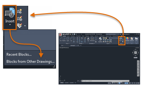

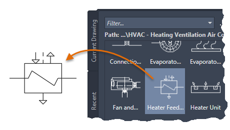

- Click Insert from the Home tab and click Blocks from Other Drawings. This starts the BLOCKSPALETTE command.

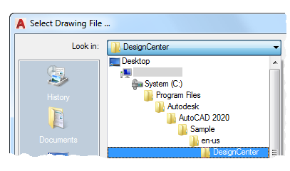

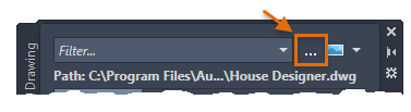

- At the top of the Blocks palette, click the Browse control to open the Select Drawing File dialog box.
- Navigate to the DesignCenter folder where a variety of sample drawings are stored.

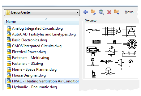

Each of these drawings contain a set of related block definitions.
Select a drawing file that interests you.
For example, let's say you create drawings for heating, ventilation, and air conditioning. Select the HVAC drawing and then click Open.
- From the Blocks palette, Other Drawings tab, select and place or drag and drop several of the blocks.
To specify a different drawing file, use the Browse control as before.
Tip: The default options at the bottom of the Blocks palette are usually acceptable in most cases, but you can experiment with them to see what options you might want to use.

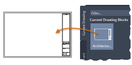

In the following example, a drawing file is inserted into the current drawing to provide a standard detail view.
Custom title blocks and drawing borders are also created as drawing files that can be inserted later or included in drawing template files. Here's an example:

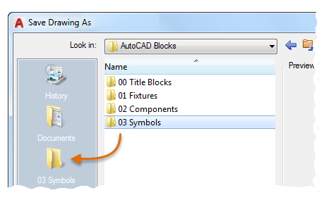

Tip: When you save the drawing, navigate to a folder, right-click, and create several folders to organize the block drawings. You can drag one or more of them into your Places list for easier access in the future.
