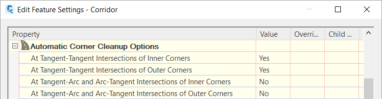

You can use these options to independently control whether the inner and outer corners of fixed width corridors are cleaned up at tangent-tangent intersections and at tangent-arc intersections.
| Before applying outer corner cleanup option | After applying outer corner cleanup option |
For more information, see About Corner Cleanup for Corridors.

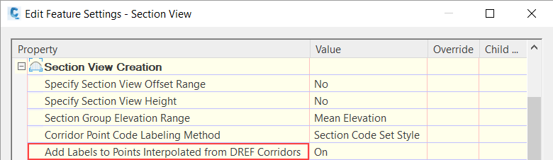

When you move the cursor over these symbols, tooltips are displayed to inform you to confirm the actual value of the label in the source drawing.
For more information about this setting, see Edit Feature Settings - Section View dialog box. For more information about labeling corridor points, see To Label Corridor Point Codes in Section View.

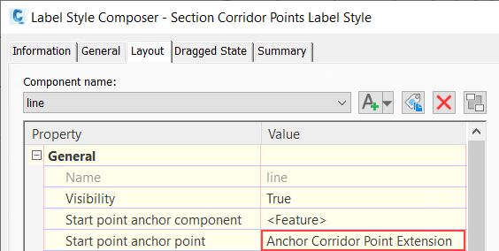

A selection dialog box is displayed when you choose to convert the labels to corridor point style labels so you can select a section label set that contains a corridor points label style.
For more information about the CorridorSectionLabelsConv command, see To Label Corridor Point Codes in Section View.
