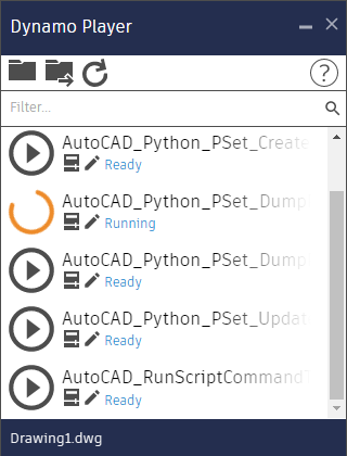

  1. Launch Dynamo Player and select the script folder.
  2. For the desired script, click Edit Inputs .

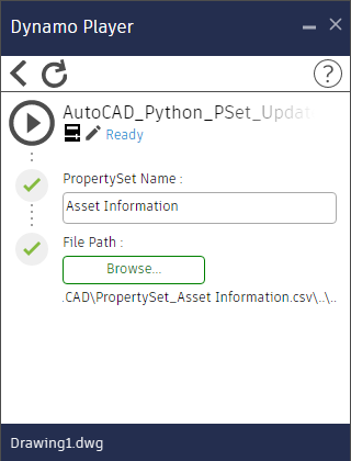

    The Inputs dialog box is displayed, listing the inputs required for the script.
    • Input needed indicates that some action or input is required.
    • Ready indicates that a valid value has been provided. This may be a default value. You can change it if desired.
    • Results Empty indicates an empty Watch node. Run the script to see results.
    Note: If the script does not require any inputs, its status indicates No inputs. Click to return to the list.
  3. For each Ready , check the value and change it if needed for the current drawing.
  4. For each Input needed , provide the required input or take action, as specified.
    When all input items are marked with Ready , the icon at the top of the window changes to and the script's status changes to Ready.
  5. Click Run Script .
