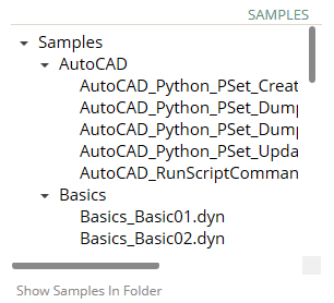

On the Dynamo Start page, these samples are listed in the Samples section:
To use the samples, open the drawing that is associated with the script and then run the script. You can open the script in the Dynamo editor to review it and run it and you can also run the script by using the Dynamo Player.
