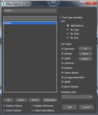

Add Max Objects
Opens the Max Objects To Mix dialog, which lists all non-biped objects in the scene. This dialog lets you add objects to be driven by your mixed animation, as well as name the mix in which they are contained.
This dialog is comparable to the
Selection Floater.
Note: The default mix name is the root node with the most children in the list.
Note: Objects can be added to only one mix at a time. Once an object is part of a mix, it is removed from the list.
