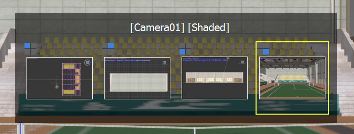

When viewports are not maximized, pressing
(the Windows logo button, sometimes labeled "Start") +
Shift cycles the active viewport. When one viewport is maximized, pressing
+Shift displays the available viewports, and you can press
+Shift to cycle among them: When you release the keyboard buttons, the viewport you chose becomes the maximized viewport.
Overlay thumbnails for switching the maximized viewport
