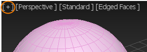

Use this menu to adjust general options for viewport display and configuration.
General menu
