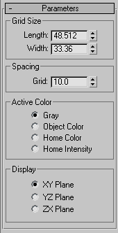

If you want to change the actual size of the grid object, select it and go to the Modify panel Parameters rollout Grid Size group, and change the Length and Width settings.

Interface
Grid Size group
Sets the overall size of the grid object. This size determines the extents of a viewport set to the grid object. It doesn't affect the useful limits of the grid, which extend infinitely.
Length/Width
Specifies the length and width of the grid.
Grid Spacing group
Grid
Specifies the size of the smallest square in the visible grid. This setting appears on the status line when the grid is activated.
Note: You can set Grid Spacing when a grid is selected, but you won't see the grid spacing until the grid is activated.
Active Color group
Determines the color used to draw the grid in viewports when it's not selected.
  • Gray The active grid object is two shades of gray.
  • Object Color The main grid lines use the assigned object color, while the secondary lines use a lighter intensity.
  • Home Color The grid object uses the home grid color assigned via the Customize User Interface dialog.
  • Home Intensity The grid object uses the grid intensity settings assigned to the home grid in the Customize User Interface dialog.
Display group
XY Plane, YZ Plane, ZX Plane
Determines which of the three planes of the grid object are displayed in the viewport.
