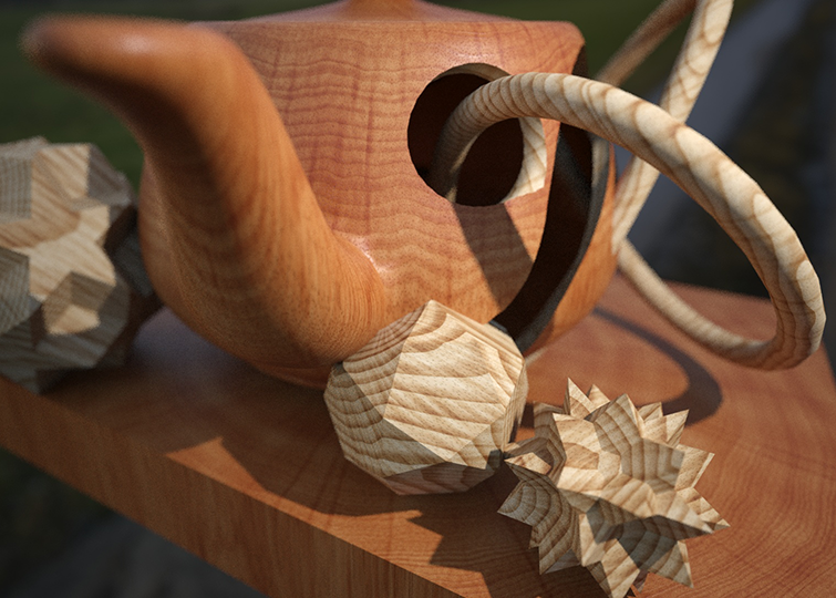

Use the Advanced Wood map to generate realistic 3D wood textures.
Note: The Advanced Wood map appears in the Browser only if the active renderer supports it.
Interface
Presets rollout
- Presets
- Choose from the presets to apply standard wood textures such as oak, pine, and walnut, along with a variety of finishes.

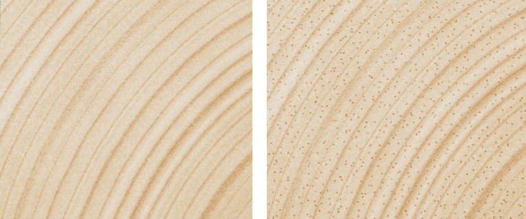

Pores rollout
Unfinished pine with early wood pores enabled (right)
Pores group
- Use Pores
- Enables the generation of imperfections on the wood surface, which appear as dots on the growth rings and as streaks along the grain.
- Pore Type
- Sets where to generate pores: either on Early Wood, Late Wood, or Both.
- Pore Radius
- Sets the radius of the individual pores. Lower values such as 0.04 tend to provide a higher level of realism. The maximum setting is 2.
- Pore Cell Dim
- Increases the density of generated pores. The maximum setting is 3.
- Color Power
- Sets the intensity of color for the pores. The maximum setting is 5.
- Pore Depth
- Sets the depth of individual pores for the purposes of bump mapping. The maximum setting is 1.

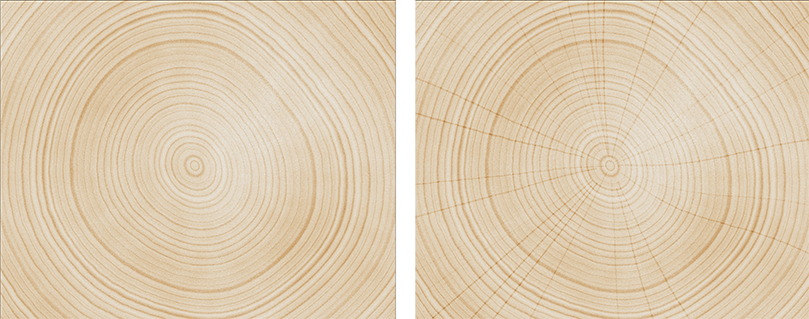

Rays rollout
Unfinished pine with rays enabled (right)
Rays group
- Use Rays
- When enabled generates ribbon-like medullary rays, which depending on the settings can be seen as lines radiating from the center of the growth rings and as short vertical lines in the grain.
- Color Power
- Sets the intensity of the ray color. The minimum setting is 0.5 (light colored); the maximum setting is 3 (dark colored).
- Seg Length
- Sets the length of the ray segments. The maximum setting is 10.
- Num Slices
- Sets the approximate number of rays to radially generate. Other ray settings may increase or decrease the visible number. The maximum setting is 400.
- Ellipse Z2X
- Sets the depth of the cells used to generate the ray. The maximum setting is 40.
- Ellipse Radius X
- Sets the radius of the cells used to generate the ray. The maximum setting is 1.
