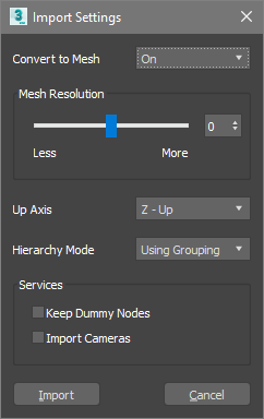

Interface: Import Settings
Properties:
.ConvertToMesh : boolean : Read|Write
Gets/sets the selection of the "Convert to Mesh" drop-down list.
When set to True (default), the imported geometry will be converted to a mesh.
When set to False, the geometry objects will be imported as Body_Object class instances.
.UpAxis : enum : Read|Write
UpAxis enums: {#x|#y|#z}
Gets/sets the selection of the "Up Axis" drop-down list.
Possible values are:
.HierarchyMode : enum : Read|Write
HierarchyMode enums: {#UsingGrouping|#UsingLayer|#Flattened}
Gets or sets the selection of the "Hierarchy Mode" drop-down list, which determines how the imported scene is organized by 3ds Max.
.MeshResolution : integer : Read|Write
Gets/sets the value of the "Mesh Resolution" slider / value.
Possible values range is from -10 (Less) to 10 (More).
Default is 0.
.KeepDummyNodes : boolean : Read|Write
Gets/sets the state of the "Keep Dummy Nodes" checkbox.
When set to True, dummy nodes will be preserved.
Default is False.
.ImportCameras : boolean : Read|Write
Gets or sets whether to import cameras.
When set to True, cameras are imported.
Methods:
No methods exposed.
Actions:
No actions exposed.
