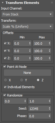

Transform Elements rollout
- Input Channel menu
- Selects an input channel: From Stack, Soft Selection, Vertex Color (Lum), Vertex Color (As XYZ), or None.
| Select:
To:
| From Stack
Use elements selected by the operator above, for example Node Influence. Blending mode should be set to Replace.
| Soft Selection
Use elements selected using a selection modifier such as Volume Select.
| Vertex Color (Lum)
Use vertex 2D float data.
| Vertex Color (as XYZ)
Use three-dimensional point 3 data.
| None
Disables the operator.
- Transform menu
- Select the transform to apply: Position, Rotation, Scale %, or Scale % (Uniform).
Offsets group
- X, Y, Z
- Sets the axes to transform and the range of the soft selection. Transforms are not applied on unchecked axes.
Point at Node group
- Point at Node toggle
- When enabled, orients face normals toward the picked node.
- Pick Node button
- When Point at Node is enabled, picks a node such as an object or a point helper from the scene. The button turns blue until the node is picked.
- XYZ toggle
- Sets the axis for pointing at the node.
- Individual Elements toggle
- When enabled, calculates the transformation using the local axis of each individual element as opposed to the local axis of the object.
Randomize group
- Randomize toggle
- When enabled, randomizes the transformation.
- Range fields
- Sets the minimum and maximum values.
- Seed
- Chooses a new integer as a random starting point.
- Phase
- Controls the speed of the animation of the random function. Use this option to animate the random function. Default = 0.0 (Noise map)
