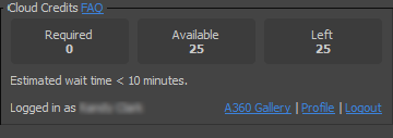

Cloud Credits group
Login
Click to log in to the Autodesk Cloud. Once you are logged in, this panel shows your resources, estimated wait time, and links to the Autodesk Rendering interface.
Tip: You can also sign in to Autodesk Rendering by using the InfoCenter Sign In field (at the right of the 3ds Max window's caption bar).

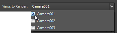

Views to Render
Choose views to render. With 3ds Max, Autodesk Rendering renders only camera views. By clicking Render, you can launch a rendering of more than one camera view.

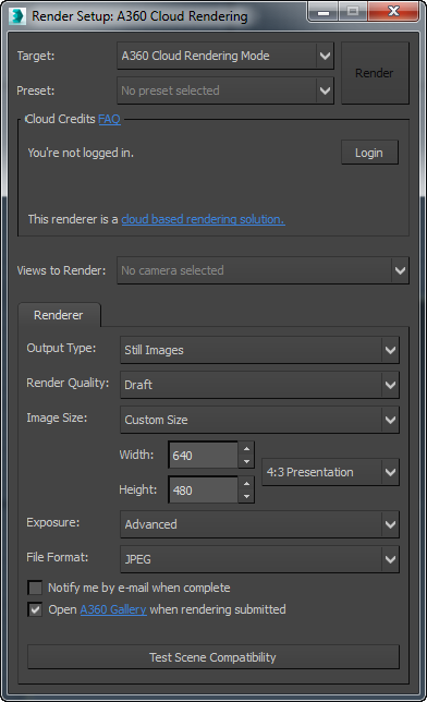

Renderer panel
Output Type
Choose the format to render. The options are
  • Still Images (The default.)
  • Interactive Panorama
  • Preview Solar Study
  • Solar Study
  • Illuminance
Note: Autodesk Rendering does not render animations. If your scene is animated, it renders only the current frame.
Render Quality
Choose the quality to render. The higher the quality, the longer the render time and the greater the cost.
Image Size
Choose a render size. The options are Custom (the default), or a standard size measured in megapixels.
The Width and Height fields show the size of the image, in pixels (default=640x480). You can edit these fields. The aspect ratio drop-down list lets you choose the aspect of the image (default=4:3).
Exposure
  • Native Uses the local 3ds Max exposure control. This must be the Physical Camera exposure control: the other 3ds Max exposure controls are not compatible with Autodesk Rendering.
    If you choose Native but the exposure control is not a compatible one, this setting reverts to Advanced.
  • Advanced (The default.) Uses the Autodesk Rendering interactive exposure control.
File Format
Choose the file format of the rendering: PNG, JPEG (the default), or TIFF.
Notify me by e-mail when complete
When on, Autodesk Rendering sends an email to signal that the rendering has completed. Default=off.
Open Autodesk Gallery when rendering submitted
When on, the Autodesk Gallery page opens when you submit your rendering. Default=on.
Test Scene Compatibility
Click to open a Render Message window that displays warnings about features of your scene that Autodesk Rendering cannot render correctly.
