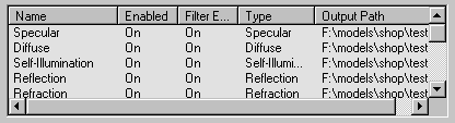

[Render Elements list]
This scrollable list shows the elements to render separately, and their status. To resize the columns in the list, drag the border between two columns.
The list includes the following columns:
- Name
- Shows the name of the element. You can change the default name of elements, in the Selected Element Parameters group.
To select an element, click its name in the list. Use
Ctrl+click to select additional elements, or
Shift+click to select a contiguous group of additional elements.
- Enabled
- Shows whether the element is enabled.
- Filter
- Shows whether the active antialiasing filter is enabled for the element.
- Type
- Shows what type of element this is.
This field is useful if you have changed the name of an element.
- Output Path
- Shows the path and file name for the element.
