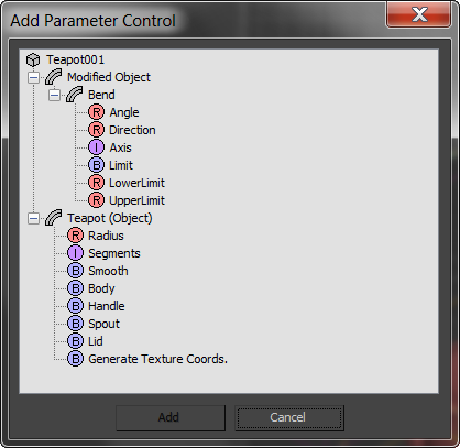

- Parameter
- The object parameter for the suboperator to use. After specifying the object (see preceding), click this button to open the Add Parameter Control dialog. Choose the parameter from the list in the dialog and click Add.
