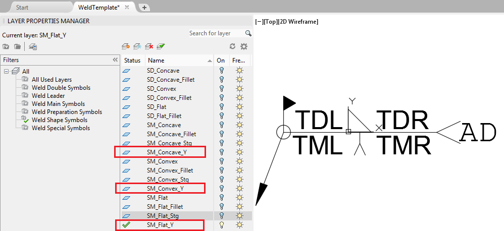

  2. Open the Layer Manager.
  3. The layer name must contain the following:
    • "SM_" (or "SD_") prefix.
    • Surface shape name: Flat, Convex, Concave.
    • A suffix (could be any suffix but it is recommended to use the name of the weld symbol as suffix, for example "_Y").
    The layer name should look like this: "SM_Flat_Y".
    Repeat steps 2 and 3 for Convex and Concave surface shape symbols.

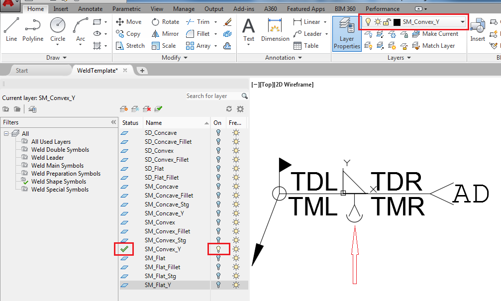

  4. Turn off all the other layers associated with surface shape symbols.
  5. Turn on the new layer and set it as the current layer.
  6. Draw the desired symbol (be sure to draw on the correct layer).

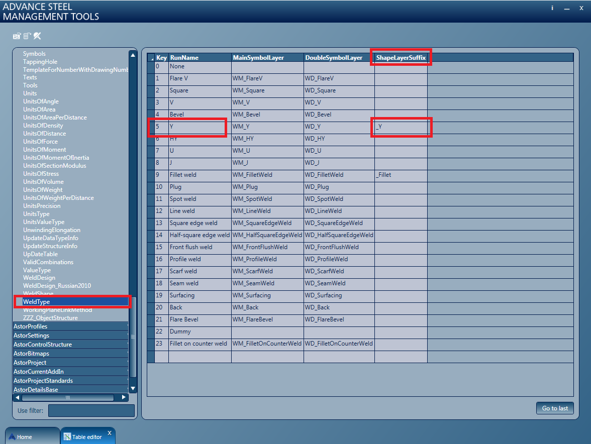

  9. Start Advance Steel and access the Advance Management Tools.
  10. In the Advance Management Tools, start the "Table editor" application.
  11. Click the Open ODBC icon and select AstorBase.
  12. Open the "WeldType" table.
  13. Search for the weld type for which the surface shape was drawn (for example, "Y").
  14. Fill in the ShapeLayerSuffix column with the suffix used in step 3. ("_Y").
