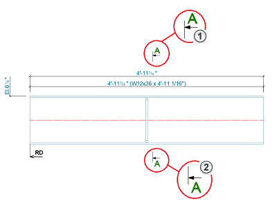

Cut views can use two different symbol resources for the "up" and "down" symbols and can be configured differently depending on the type of detail drawings that can contain cut symbols:
- General Arrangement
- Shop drawings (both assembly and part drawings)
- Weld preparation
1- Cut Symbol Up
2 - Cut Symbol Down
