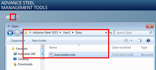

  2. Select the Table editor.
  3. Based on the category of the drawing style (Advance or User), open the following database clicking (Open database):
    • AstorDetails database: ...\ProgramData\Autodesk\Advance Steel 2020\[INSTALLATION LANGUAGE EXTENSION]\Steel\Data\ (for drawing styles used from the Advance category)
    • AstorAddIn database: ...\ProgramData\Autodesk\Advance Steel 2020\[INSTALLATION LANGUAGE EXTENSION]\User2\Data\ (for drawing styles used from the User category).

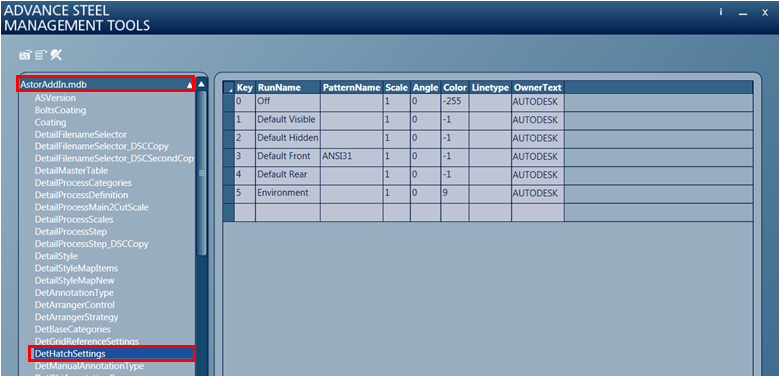

  4. Open the DetHatchSettings table.
    The various types of hatches that can be configured into an object presentation are available. The default hatch, used by both automatic and manual cut views, is Default Front.

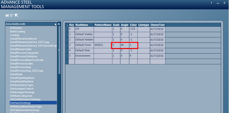

      -1 - Read code from defaults. If we use this setting, then the color will be read from a specific default value. For example, for the Default Front hatch, it will read the color from the "Drawing-Presentation / Color of planes of intersection" default.
  5. After configuring the hatch, close the Management Tools and use the "Update defaults" function in Advance Steel to include the modification.

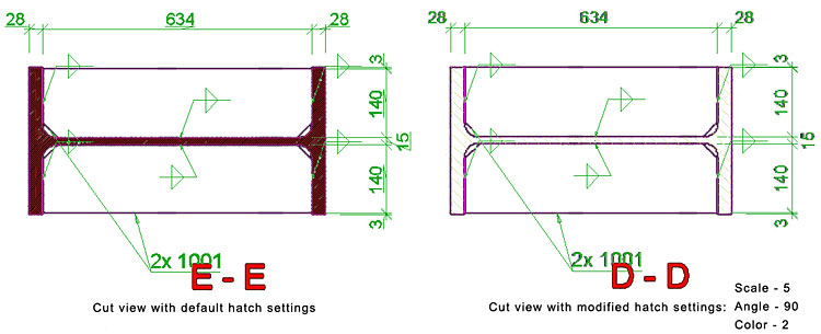

    Note: In order for the modification to take effect on detail drawings, we need to recreate them. A drawing update will not change any of the modified settings done to the database table.
As an example, change the scale and color of the Default Front hatch with the following values:
