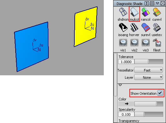

The Multi-Color mode of Diagnostic Shading uses blue and yellow colors to show the surface orientation when the Show Orientation option is turned on. Blue means that the front of the surface is facing the viewer. Yellow means that the back of the surface is facing the viewer. Once again, this orientation is independent from U, V, and surface normal, as shown in the following image.
