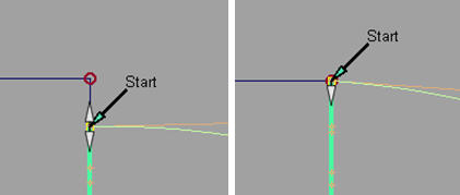

Start Align/End Align
Edge Align – The edge is aligned to either the natural boundary or to a trimmed edge.
Skew – The edge is rotated by the specified Skew Angle while remaining in the tangent plane.
Click the label in the view window to toggle between Edge Align and Skew.
Start Skew Angle/End Skew Angle
The angle of rotation (in degrees) of the start or end outer edge.

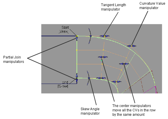

These values can also be adjusted by using the small circle manipulators in the view windows.
The following section only appears when Continuity is set to G1 Tangent, G2 Curvature, or G3 Curvature.
These options control the length of the tangent or curvature. You can also use the tangent and/or curvature manipulators to adjust those values.
Tangent and Curvature CV Adjustment
Starting Tangent Scale/Ending Tangent Scale
These slider values let you adjust the true lengths of the tangents (in centimeters) along both edges of the Input surface.
Tangent Scale
This slider value lets you adjust the true length of the tangent (in centimeters) at the aligned end of the Input curve.
When aligning surfaces, if Tangent Balance is on, this slider lets you scale the tangent lengths in a proportional way, so as not to change the shape of the surface. It retains its value if Tangent Balance is toggled off then on again.

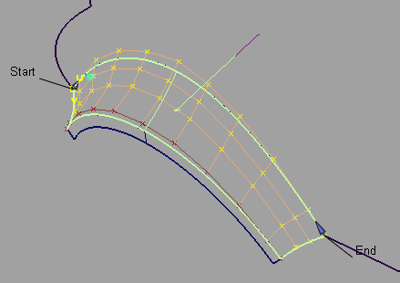

Partials
Start / End
These sliders values range from 0.0 to 1.0 and specify the percentage of the way that the start or end of the Input surface extends from the end of the Master surface (in parameter space).
These values can also be adjusted by using the Partial slider manipulators along the boundary. The manipulators indicate they have been positioned at the full extent of the edge of the Master by displaying only the internal arrow. Double arrows indicate that the Input edge is not positioned at the full extent of the edge of the Master.
The Partial slider manipulators also snap to the options set in the Snap Options window (except for Snap to Center and Pivot).

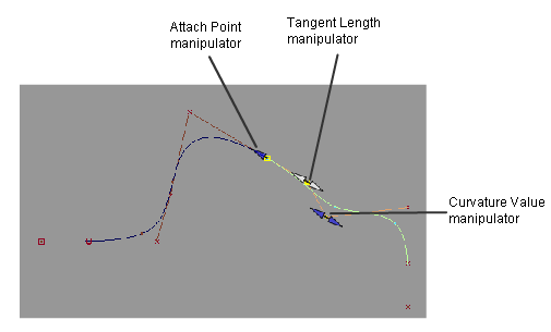

Attach Point
This section applies to curve alignment only.
Attach Point
Point on the Master curve that the Input curve is aligned to. The slider value ranges from 0.0 to 1.0 and specifies the percentage of the way from the start of the Master curve.

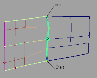

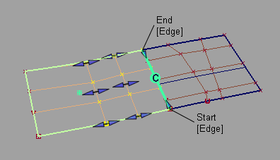

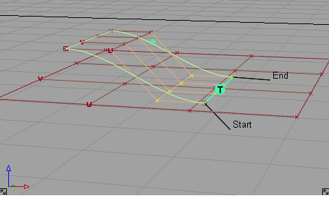

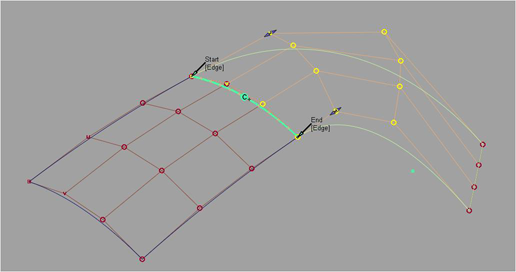

Using the manipulators
Surface alignment manipulators
Curve alignment manipulators
