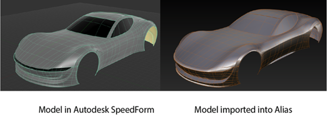

You can now import SpeedForm T-Spine surfaces from SF3D files directly into Alias as subdivision bodies. This means that you no longer need to convert T-Splines models to OBJ files before importing them into Alias.
To do this, select File > Import > Subdiv. Ensure that All Files (.) is selected in the file Open window so that your SpeedForm SF3D files appear.
When you import T-Splines, the models get converted to Alias subdivision bodies. Creases in the T-Spline model are preserved in the resulting subdivision body. Symmetry that has been added to the T-Spline surface in SpeedForm is removed and is not transferred to the Alias subdivision body.
NURBS surfaces created in SpeedForm using the Detailing workspace are not supported.
See Transfer subdivision bodies between Alias and Autodesk SpeedForm.

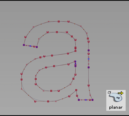

The Set Planar tool (Surfaces > Planar Surfaces > Set Planar) now indicates which selected curves have open and closed intersections. In addition to the Error creating a trimmed surface message appearing in the Prompt line, red crosses display at open curve intersections. Yellow dots also display when closed intersections are detected. With this feedback, you can quickly identify which curves need correction so that the tool can successfully create the trimmed NURBS surface. Note that red crosses display on curves when:

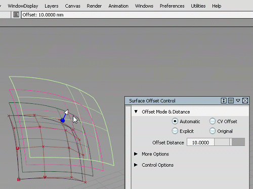

You can now enter offset values for the Curve Offset and Surface Offset tools directly in the Prompt Line.

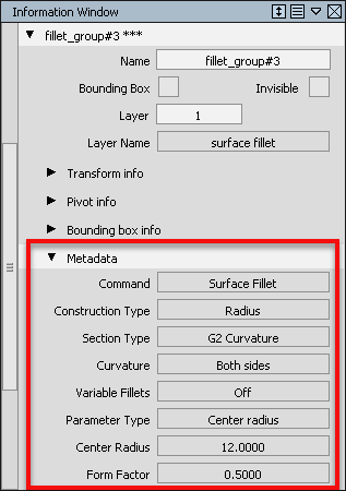

The Creation tab in the Information Window has been renamed to Metadata. Now, when you select an object with metadata, you can view this information in the Metadata tab of the Information Window.
