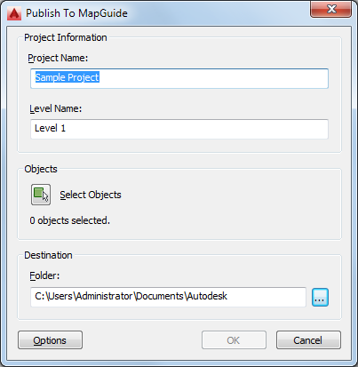

If the drawing from which you want to publish objects is part of a building project, the project name and level assignment of the drawing display in the Publish to MapGuide dialog box.
If the drawing is not part of a building project, the name of the drawing and “Level 1” display by default. You can change these entries.

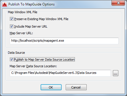

| If you want to... | Then... |
| preserve the existing Map Window XML file | select Preserve Existing Map Window XML file. This option will prevent an existing MWX file in this location from being overwritten. This will allow users to preserve any changes they made to the MWX file (secondary data source table selections, layer properties, or themes) when updating or re-publishing the underlying data or geometry. |
| include an URL to a Map Server | select Include a Map Server URL, and enter a server address. |
| publish your data to a Map Server data location | select Publish to Map Server Data Source Location, and browse for a location. |
