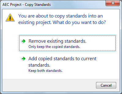

- Select the copy settings.
| If you want to… |
Then… |
| overwrite the existing project standards with the copied project standards |
click Remove existing settings. |
| add the project standards from the selected project to any existing project standards |
click Append copied settings to existing settings. Existing settings that are inconsistent with the copied settings will be replaced with the copied settings.
