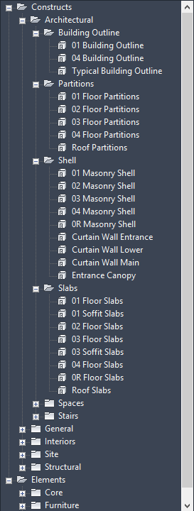

The Drawing Explorer is a tree view common to the Constructs, View, and Sheets tabs of the Project Navigator. This is where the drawing files are organized. Each tab of the Project Navigator except the Project tab has a Drawing Explorer tree where the associated project drawing files—elements, constructs, views, and sheets—are displayed.
Drawing Explorer
Drawing files belonging to a project are displayed on their respective tabs in the Drawing Explorer tree view, which lists the drawings in their category (folder). You can drag and drop, or copy and paste drawing files in the Drawing Explorer.
Drawing Explorer of Constructs tab fully expanded
