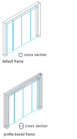

Use this procedure to create a frame element definition from a profile. If you do not want a straight edge to your frame, you can use a profile to define edges with curves, jags, or any other shape you require.

Specifying default and profile-based Door/Window Assembly frames

 . These dimensions are used to calculate the center point of the edge for aligning the profile and also to specify a boundary for the adjacent infill.
By default, the profile is inserted using the same width and depth with which it was created.
