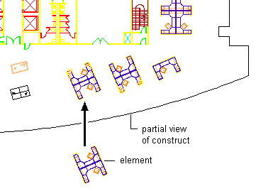

Use this procedure to reference an element into multiple constructs.
This procedure is useful for updating a number of similar floor constructs in a building.
Referencing an element into a construct
| If you want to… | Then… |
| attach the element as an external reference | select the construct, right-click, and click Set to Attach. Note: If the Set to Attach command is unavailable, the element is already set to attach.
| overlay the element as an external reference | select the construct, right-click, and click Set to Overlay. Note: If the Set to Overlay command is unavailable, the element is already set to overlay.
Elements are attached at 0, 0, 0.
