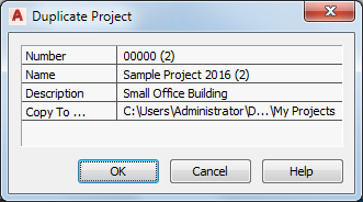

- In the Duplicate Project dialog box, enter a number for the new project. Each project needs a unique identification number. You can use numerals, alphabetic characters, or a combination, such as 100A. The project number appears in the project header.  The number you assign here can be used as a prefix for all drawings you create in the project. You can also use the number as a property for a title block.
- Enter a name for the new project.
- Under Description, if desired, enter a description brief enough to be displayed in the project header. Details about the project can be entered on a separate worksheet.
- Under Copy to, select a folder in which you want to save the copied project.
- Click OK.
