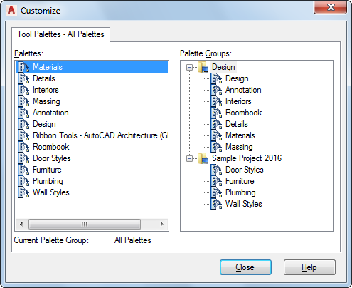

Selecting the project tool palette group
 , and click Customize Palettes.
On the left, all available palettes are listed. On the right, all palette groups are listed. The empty project tool palette group is listed there.
 again.
 again. The project tool palette group is listed under the available palette groups and can be selected and displayed.
