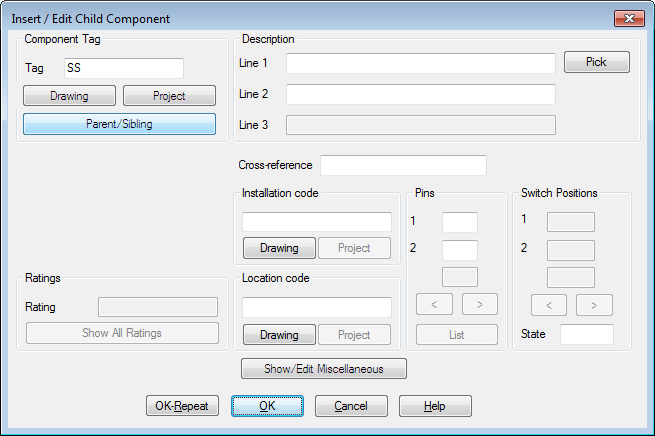

  7. In the Insert/Edit Child Component dialog box, click OK.

  4. In the Insert/Edit Child Component dialog box, Component Tag section, click Parent/Sibling.
  5. Respond to the prompts as follows:
    Select component:
     Select the bottom sibling contact (3) of the existing switch on line reference 408
    AutoCAD Electrical toolset reads the sibling contact and transfers the appropriate annotation to your new switch contact.
  6. In the Insert/Edit Child Component dialog box, click OK.
