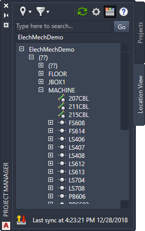

Displays the devices in the project, organized by Installation and Location. Devices include standard components, terminals, PLC modules, and cable markers.
Find
Command entry: AEPROJECT
Select the Location View tab.
List of Options
The following options are displayed.
Buttons
Filters the tree view by Installation and Location.
Refreshes the component tree and the Details and Connections pane based on the AutoCAD Electrical toolset data.
Opens the Details and Connections pane. The Details tab shows the component values such as Installation, Location, and catalog. The Connections tab shows wiring information for the components. Right-click to change the fields to display on each tab.

Component Tree
Displays a list of standard components, terminals, PLC modules, connectors, and cable markers. The top node in the tree represents the entire project. Each node under the project represents an Installation value. The nodes under each Installation represent the Location values within that Installation.
The various device types are represented differently in the component tree. When inserting electrical components, it is recommended that you should have unique names (installation code, location code, and component tag), pins, and terminals numbers. For example, if you have cable markers in your drawing, which has duplicate values for cable tag, then you may experience unexpected behaviour of the component in the component tree view and in the connections tab. This is more commonly observed for terminals and cable markers in Location View.

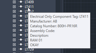

Note: Hover over a device node to display more information about the device, such as catalog and description.
Electromechanical Status Icons
If the project is part of an electromechanical association, the icon in front of each device indicates both the device type and its link status.
