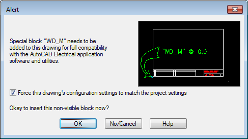

Click
. Find
The alert displays.
- Click OK to insert the WD_M block.
